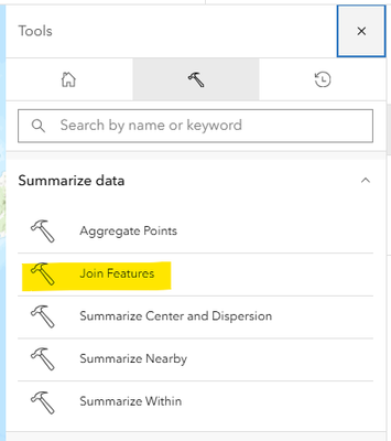

Hi @JoseSanchez,
If you have the proper permissions, you can use the Analysis tools > Join Features tool in Map Viewer.
Your organization adminstator can grant you permission to access the Analysis tools. For more on that, see the Help site  here.
