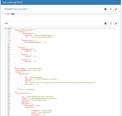

As far as restoring an item from JSON if you accidentally deleted it or if I just want to compare the current vs backed-up item, I create a brand new webmap or dashboard manually in Chrome and copy/pasted the JSON from the backup and overwritten the existing JSON using https://ago-assistant.esri.com/.  Problem with that is you'd get a new item ID which could break other things like scripts or links you'd already established.
I've used the script mostly to:
  1. See what items in my ORG were changed when and have a log each day to refer back to or to restore back to
  2. If an item really got screwed up, I would go into AGO Assistant and replace the json with the backup json and see if that fixed the item.
I go in AGO Assistant.  I search for the item (by default it only display items you own) by name or itemID.
Find the item and in the dropdown choose I want to...View an Item's JSON
Replace the Data of it's json with the .json file you have backed up on your network.
Hit save and then view that item in Chrome or Field Maps.
