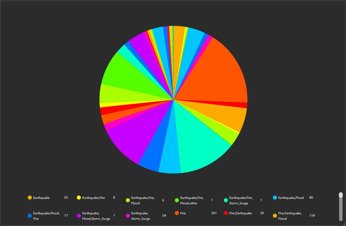

Hi everyone, I'm kinda new is ArcGIS online, I have some queries about dashboard and data expression.
I want to combine the data of each hazard so that I can count the total of each hazard but I don't know how can I do it because when I open the New Data Expression, it says that "This profile does not have any variables."
Here's the data I want to combine and seperate from other hazard.

There's a more in-depth discussion here with example code that seems? like it's what you're looking to do
arcade-expressions/dashboard_data/SplitCategories(PieChart).md at master · Esri/arcade-expressions ·...

Thank you for this solution, I already solved it.

I think the GroupBy() function is what you want. There are some examples in the documentation.
RAMON_VERANO
