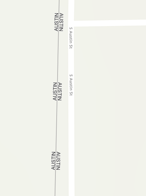

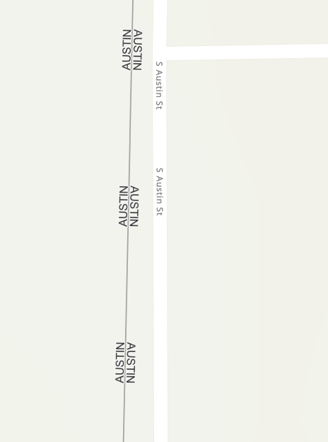

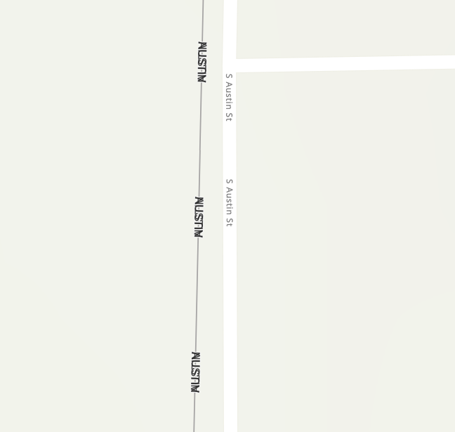

Hello,
We have a public street centerline layer that was set up with labels.  Prior to the recent update the labels worked fine (arcade expression concatenating fields, no filter, placement: center along, enable deconfliction, and repeat label).  Now all the North/ South street labels are appearing as duplicates and drawing on top of one another (for only one feature line).  One label points North, the other South.  Is anyone else seeing this in their line layers?  Is this a known bug?
Images show center along and above along.  Arcade expression removed to see if that was the issue...

GISMaryWagner
Here is the Bug # Assigned: BUG-000185883 - although it states that the label duplication is because of using an arcade expression which isn't really the case.  Any field I use for labeling duplicates on line features where there is 90-degree label rotation.
RussRoberts
Esri Notable Contributor
Thanks for reporting this. I can reproduce this with your layer and will try to address it ASAP in a patch. If you can contact support you will be able to get a bug # for tracking and I can link to my internal dev work.
