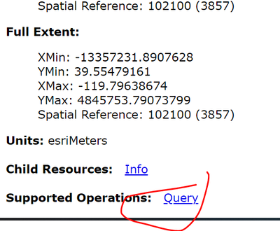

I have an AGOL hosted feature service that is publicly shared.
Currently it looks like the only Supported Operation, as shown in the REST endpoint, is Query.
Are other capabilities such as Identify (which we see in ArcServer services) possible?
Jay

It is looking to me like perhaps the Identify operation is specific to Map Services and doesn't apply to Feature Services.  Can anyone confirm this suspicion?

JayJohnsonWashoeCounty
Dylan,
The service was published to AGOL by another organization, so I don't have control over the "dynamic" functionality.
One of your links, however, led me to the answer I needed about the capabilities of services.  "Identify" is only an Operation available for Map Services, not Feature Services.  So thanks for that!
Jay
Washoe County GIS
