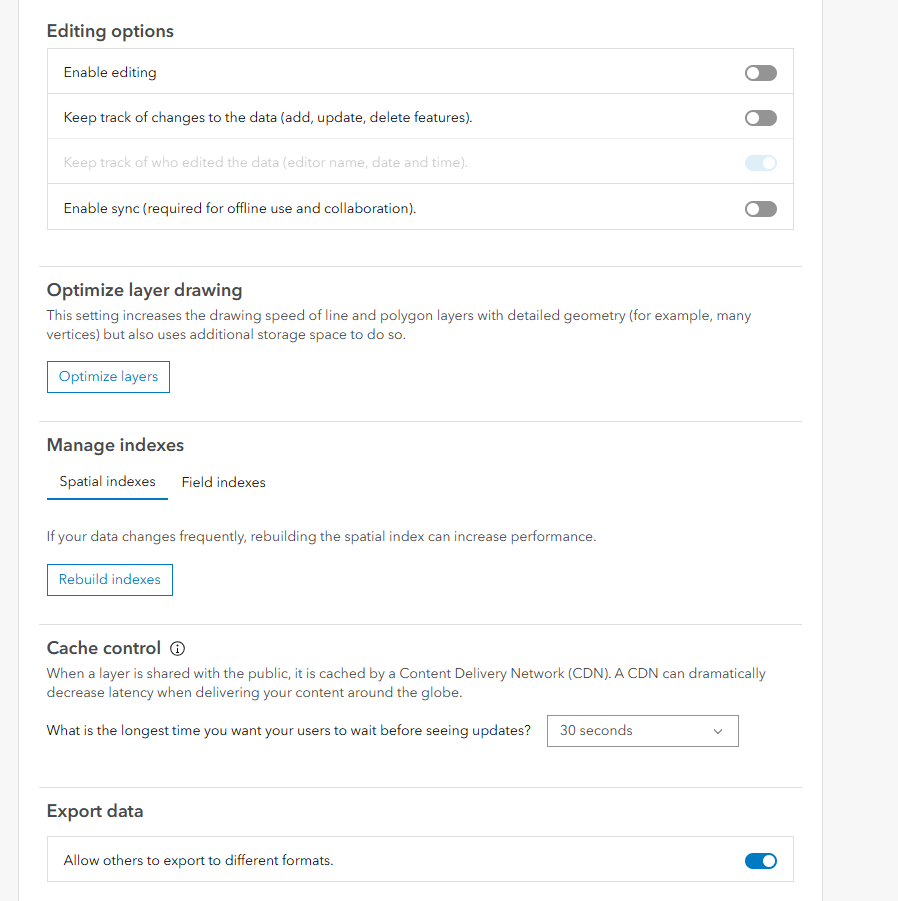

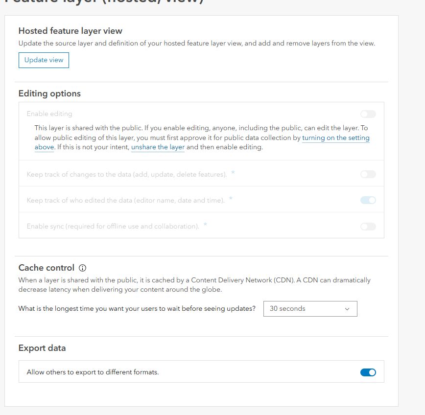

There are two parts to this HFL - a source (export enabled, only shared with owner) and the view (export enabled shared with everyone and the data download group).
I have tried to turn the enable export on/off to try and refresh but that doesn't seem to work.

Settings for hosted view layer:
settings for the hosted source trails layer
We have this set up with a couple other public layers (a non-shared source and a public view) that works as expected, so I'm just not sure what is going on with this one.  Really trying to avoid recreating this layer as it's one of our most used datasets!
