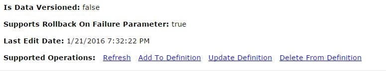

In the service URL of the layer I want to delete I see, "Delete from Definition". But does that just delete a few fields in that layer and not the layer itself?
Does anyone have any ideas?

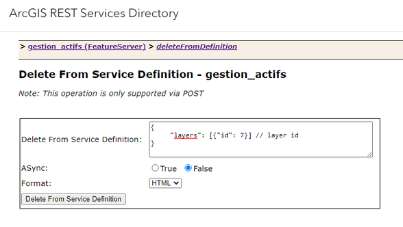

You are trying to delete a layer inside a feature service, correct?
I have done this multiple times with the deleteFromDefinition endpoint of the REST API.
You can write a json similar to this on the html page if you are not familiar with API calls.
     "layers": [{"id": 7}] // layer id

mikaël
