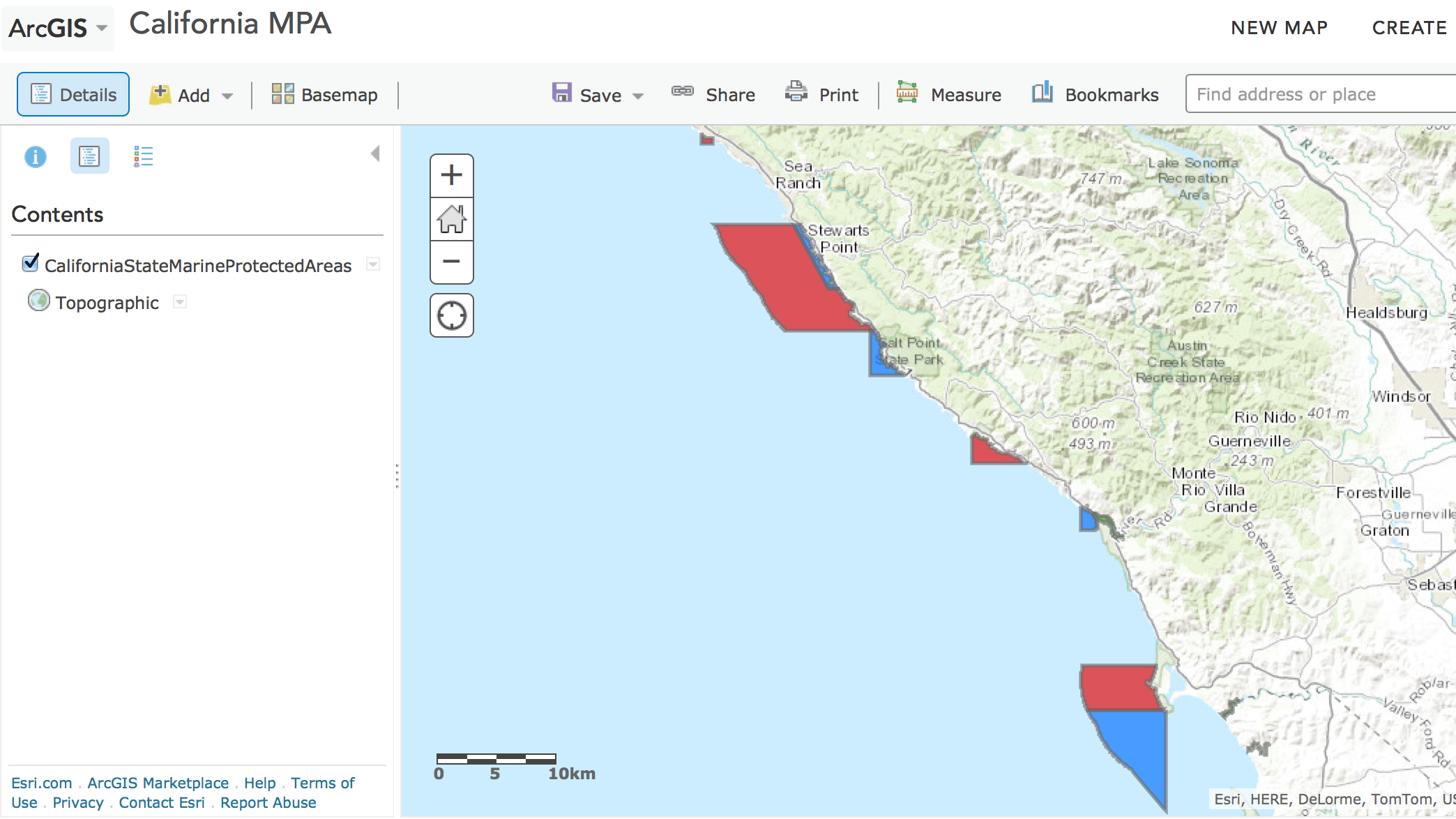

Created a map using that KML file which displays what I want to see when I look at it on the computer.

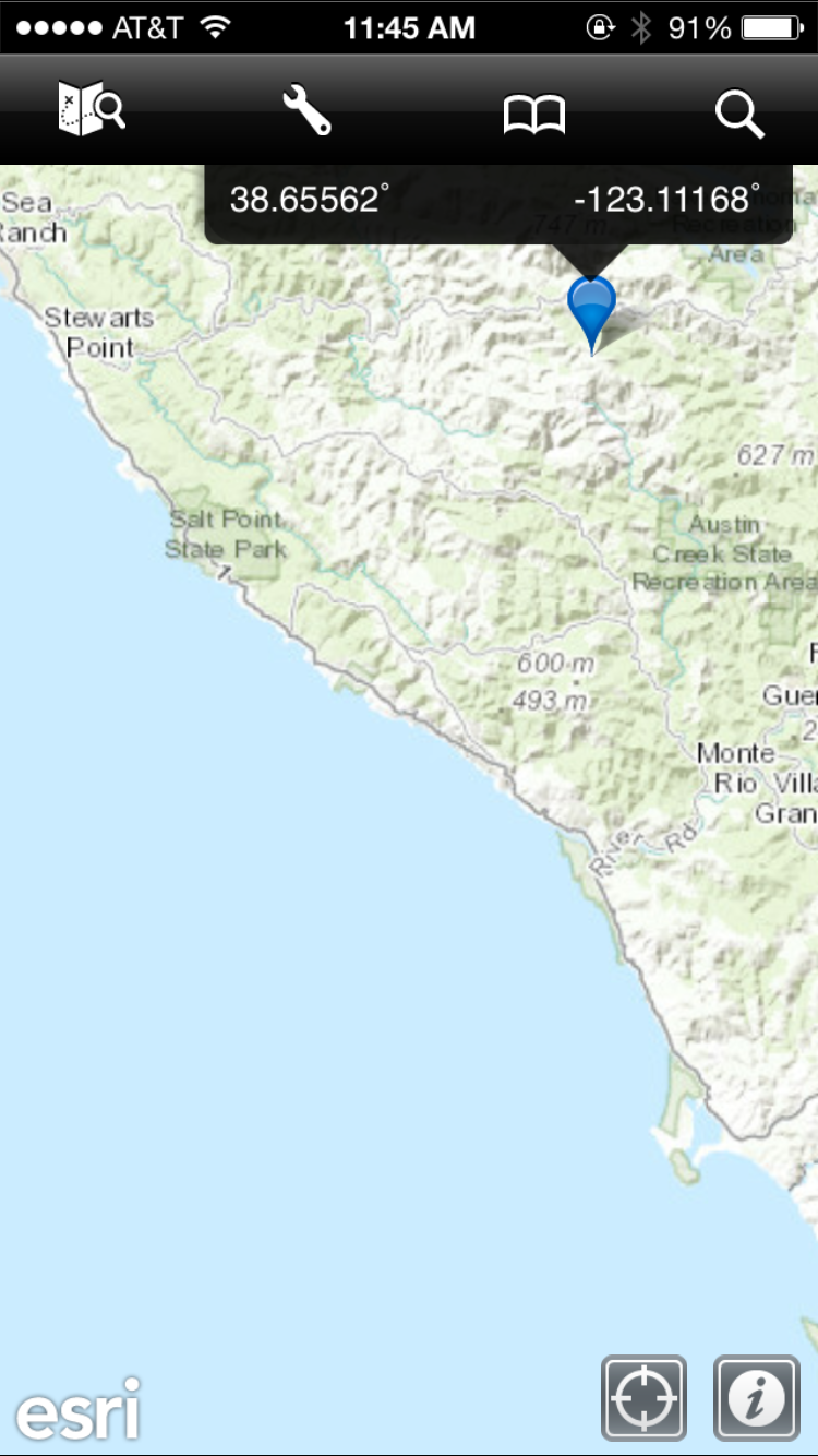

The map opens to the basic area of the map I'd created online, but only the basemap appears.  None of the details I added appear.
This is what the map looks like in the browser on the computer:
And here's a screen shot from the iPhone showing the same geographic region:
Any thoughts here?

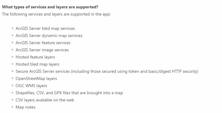

Hi Ben,
It would appear that KML is not supported in the ArcGIS for iOS app:
Work with my data—ArcGIS app for smartphones and tablets | ArcGIS
