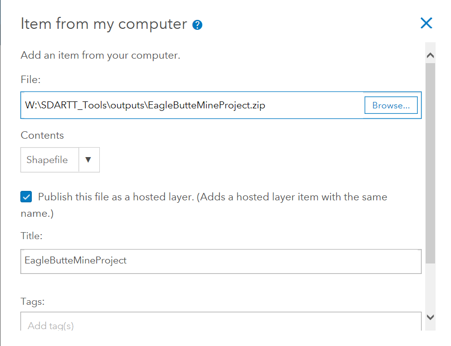

I took a look at your screenshots - can you let me know what your role type is? User, contributor, publisher, something custom, etc? To check this, go to the Organization tab and search for your name - this will show you what role you have.
Also, can you screenshot the dialog that you see when you upload your zipped shapefile to ArcGIS Online? If you are a publisher you should see a checkbox option to  publish the file as a hosted layer - you'll need this ability in order to add it to your map. Here's an example:
It definitely sounds like it might be a permissions issue.

I have a student account and no organization associated with my account. I have my school listed as organization but my account isn't "connected" to the school. I do not know if that means I cannot add files because I thought I was able to.
When I try to add a zipped shapefile to My Contents it looks exactly like your screenshot but it is completely missing the "Publish this file as a hosted layer" option (there is no checkbox or text).
