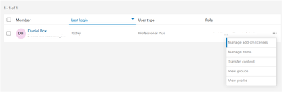

I am trying to change the roles of some users to remove the amount of admins we have. When I try to change their role from admin to user it says they have groups with hidden members and it won't let me change their role.I assume this is something only an admin can do and that is why I can't change the role. How do I find the groups with hidden members and who the hidden members are?
DanielFox1
Hi @LouiseHarris1
Under the members tab in the organisation you should hopefully be able to see the user and then using the three dots view groups for that user
