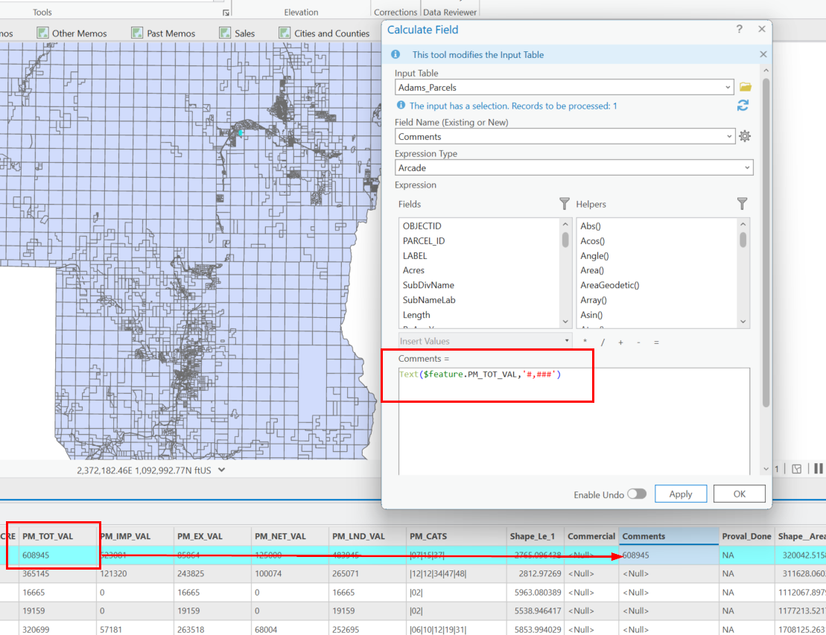

Is anyone else seeing the below issue in both ArcGIS Online and ArcGIS Pro (when connected to the hosted feature service)?
Using Arcade to format text strings as numbers with dollar signs and thousands-separators is no longer working like it used to. This is very frustrating because it's incredibly useful when creating online maps and apps from data that has numbers in a text field. Many datasets come this way and Arcade is supposed to help save us save time by creating those labels via expressions on the fly instead of having to add number fields and calculate the values from the text fields. Having to add fields means there are more fields to maintain, it adds work during updates, and is just a pain.

Here is an example of me attempting to run this calculation on a hosted feature service in ArcGIS Pro - as you can see the Comments field shows the exact same text string without the additional formatting of the thousands separator.

Hi @KaraUtter2 ,
Formatting a numeric field this way is working for me in both Pro and Online.
What is the field type for the field you are using in the expression? It sounds like you may be trying to format a text field using the text function. I'm not sure that's supported. The text function is typically used to format other (non-text) field types, such as double, integer, float, etc.
But, you can still use Arcade to get the results you want. One option is to cast the text to a number first, then you'll be able to format the resulting number using the text function.
For example:
var mytext = $feature.nameofyourtextfield*1
return text(mytext, '$#,###')
