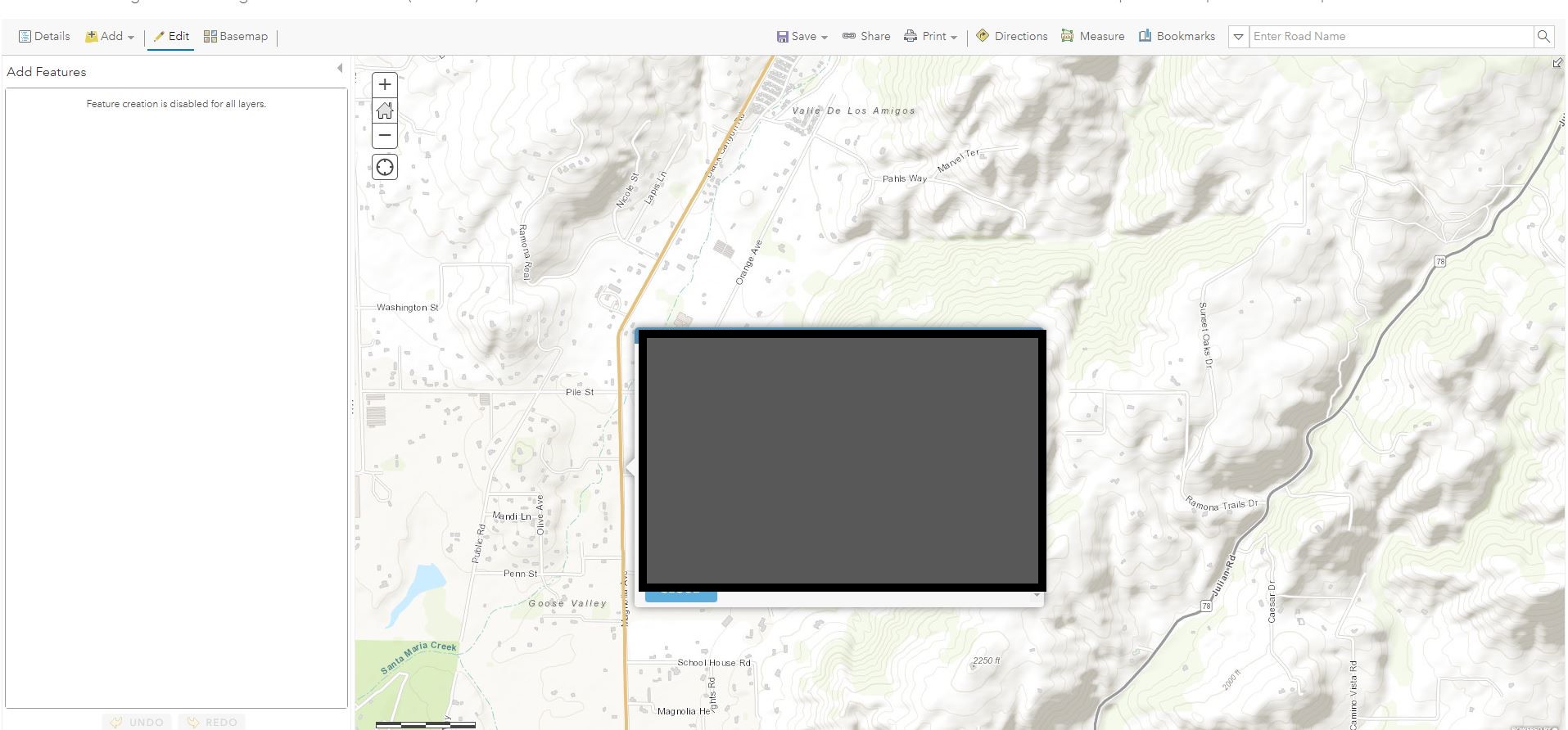

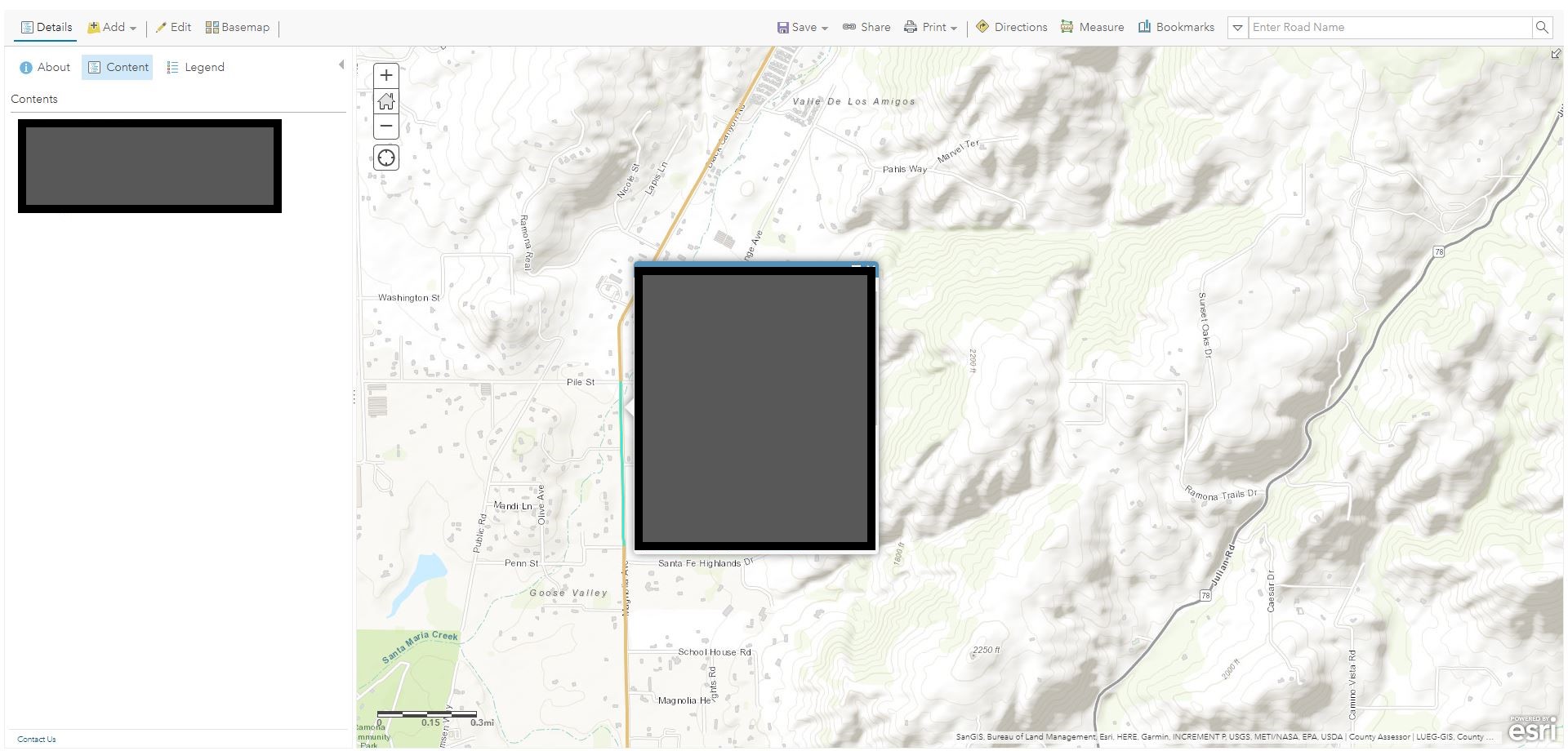

I noticed that when I edit a feature, the feature isn't highlighted when selected (see first screenshot). The features only highlight outside of edit mode (second screenshot). This map will be used by non-GIS users, so I want to enable some kind of highlight to make it easier for them. Is there a setting that I need to turn on? I can't find much information about this issue.  nohighlight.JPGhighlighted.JPG

It looks like you're using Map Viewer Classic. The cyan highlight does not appear when editing selected features in classic. But you should see something like this:

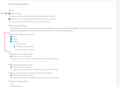

@jeromewu68 In the settings to the layer, what kind of editing is allowed?
jeromewu68
Hi, I ended up using a view only MIL layer but I had the same setting for Editing and allowed Update Attributes only. It seems like highlighted features in Edit mode is only available for the new Map Viewer? I'm not entirely sure.
