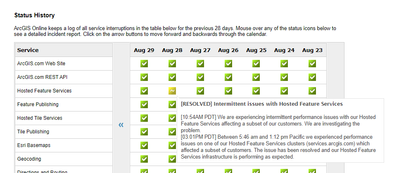

Looks like there may have been some issues on the 28th with hosted services https://status.arcgis.com/
If you continue to have issues, I'd suggest contacting Esri Support.
