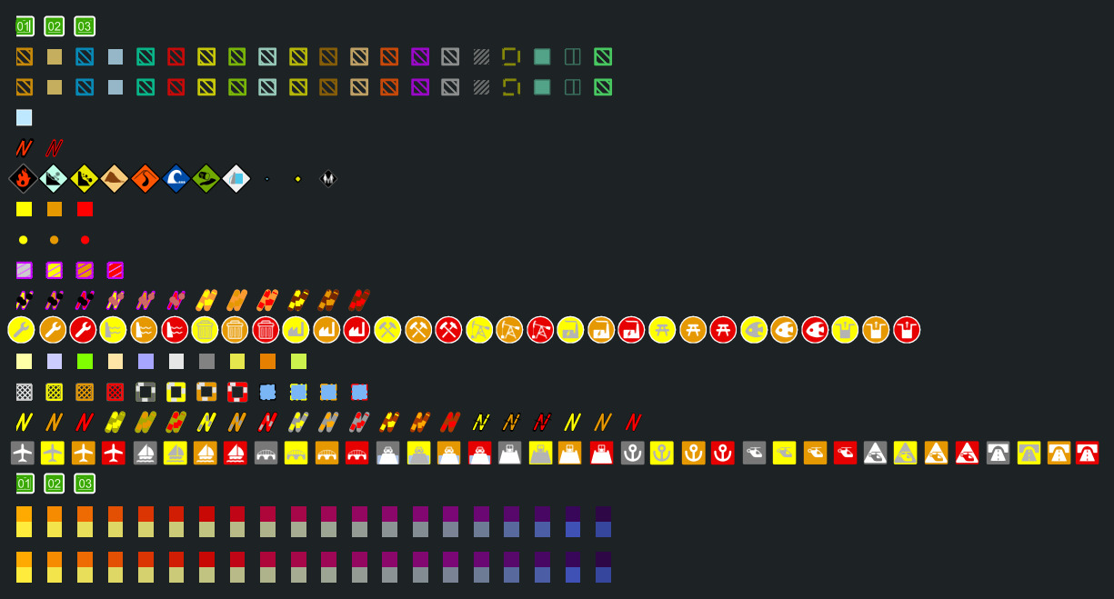

Considering the frequent breakage of tile service publication related to our custom environment, I have reconsidered the idea of using feature layers instead, by making slight changes to the symbology, in a way that still closely complies with our specifications. Manual publication works perfectly fine, be it for a web map that includes all our layers, or for layers taken one by one. You will find a screenshot below illustrating said symbology. The web map itself is available at: https://arcg.is/uHqbj0, with dummy geometries.
However, considering the amount of updates we can publish in a day, feature layers need to be automatically published, hence using arcpy. I have tried to get it to work, but every single time, the symbology gets lost, be it by publishing a single map with all the styles, or layer by layer.

Hello - looks to me like everything is a vector style-type symbology in the webmap.  Can you tell me what version of Pro you are on?  Are these hosted feature layers in ArcGIS Online or Enterprise?  If Enterprise, what version?
Finally, since you saying that once you use the ArcPy Feature sharing module to do sd overwrites - CreateDraft>Stage>UploadServiceDefinition - and that you do have "useCIMSymbols" set to True - do you have a stylex that you have shared as a webStyle in your org?
It may be that if you don't have a matching style in your org that may have some impact.
DavidColey
MVP Frequent Contributor
Hello - if you look at the help, you do have to have a matching stylex file that you have shared as a Web Style to your Online or Enterprise org.  Otherwise you'll keep having this problem.
