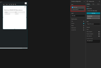

@WFCAdmin - You can accomplish this by using the "selected features" option under the Feature Info widget Configuration.
When nothing is selected it will show the message, this can be changed to a custom message or leave it blank.
