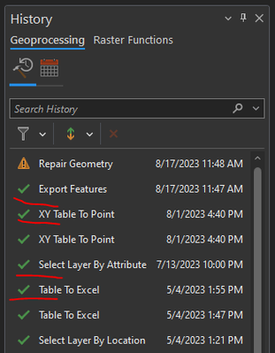

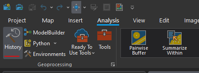

There is not really a way to do that. Your best bet is to go into the Analysis ribbon in ArcGIS Pro and click on History. This will show you a list of your geoprocessing tools and you can even drag those into a modelbuilder and build a model from there:
That is assuming your did your geoprocessing in ArcGIS Pro.
