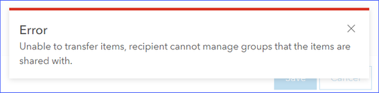

Our Org has given some of our users the new, non-admin permissions to transfer ownership of their content to other users.
These transfers require the recipient to have appropriate access to any groups that the item is shared with.
i.e. If the recipient can't share to one of the groups the item is already shared with, the item wont transfer and they receive this error:
This is all well and good, but we have been seeing this error on some transfers where the recipient has the appropriate access, and even when the content is not shared to any groups.
Has anyone else using these permissions seen this error when the recipient appears to have the correct group access?
WalkerHenry__NIFCAdmin
Huge thanks to the FWS Admins for figuring this one out!!
It appears that a user's Favorites are stored in a secret/hidden group and this is what is triggering most of the errors where the recipient has the correct group permissions. There are other cases where not all sharing is immediately apparent, resulting in similar a 'hidden group' scenario, but these are less common.
If your Org has experienced this issue, please request to be attached to the bug so that it can be prioritized for a fix as soon as possible. Thanks!
BUG-000149718: Unable to change ownership of an item if favorited by another user.
