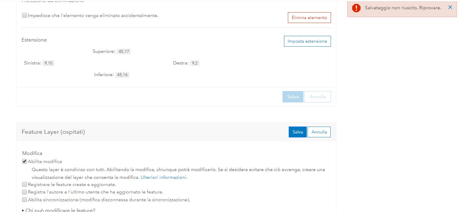

I am experiencing this strange issue.
I have a Feature Layer associated with (published as) a Scene Layer.
I connect to my AGOL organization as the owner of these layers.
I published them automatically from ArcGIS Pro by sharing a web scene with a multipatch layer.
Now, I have to enable editing in my Feature Layer, but as I try to activate the option "Enable editing" (in the item detail -> Settings), and save, I always receive the error "Unable to save. Try again." (it's translated directly from Italian, the message in english could look a bit different).
error while saving item settings in agol
I need this to use the layer inside Collector.
Any idea why this is happening?
Thanks.

Ok, answered myself: multipatch feature layers cannot be edited.
From "Three Tips for Publishing Scene Layers from Feature Layers":
Note that multipatch feature layer editing is not supported so you will have to edit the data locally in Pro or ArcMap and overwrite the feature layer.

AlessandroValra
The error in english is exactly Save wasn't successful. Try again later.
I changed the language settings to English to check if this was the cause of the problem but apparently it's not.

Moreover, inspecting the response from the dev tools when clicking the "save button" in the item details (not from REST) this is the message:
{"submissionTime":1523615946600,"lastUpdatedTime":1523615946600,"status":"Failed","error":{"code":500,"description":"Editing definition error - Pavia_WSL1"}}
