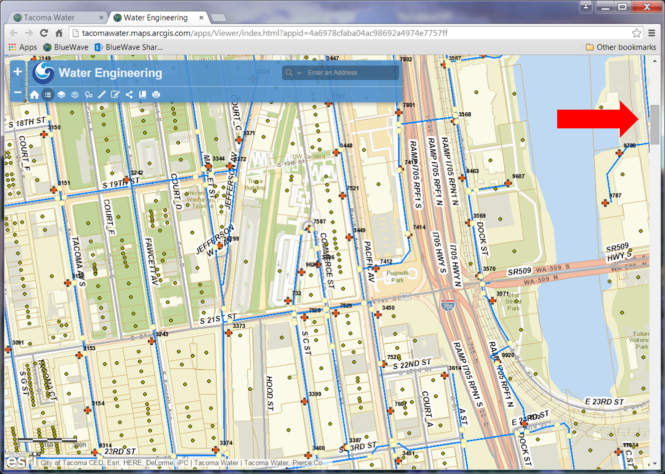

We have been making adjustments to our ArcGIS services during the last couple of weeks. We use the AGO basic templates for all of our applications. Sometimes the tools fall off of the toolbar, other times the tools appear but don't work. This morning for example, all of the tools are displayed but when you click them, nothing happens, the menus don't appear on the right side as they usually do. Strangely, you can see the scroll bar moving down as if the menus are being displayed. Has anyone else been seeing this behavior? Surely we don't have to open and resave our applications every time we republish our services, do we? By the way, the data displays fine. That's the odd thing - it's just the tools that aren't behaving.

See screen shot below. Notice that some of the tools aren't appearing on the toolbar. This is a typical problem. Today's issue started with all the tools displayed but not working. We are on the phone with esri tech support now.

As they are working through the issue, it's back to the way it was first thing this morning. All of the tools but when you click on them, they don't do anything. Look at this series of screen shows and note that as I select the tools, the scroll bar moves down as if it thinks it is displaying.

I typed the root URL of http://tacomawater.maps.arcgis.com/apps/Viewer/index.html  and your print tool is throwing an error:
POST http://tacomawater.maps.arcgis.com/sharing/proxy?http://twgreenriver1/twpub…ervices/Utilities/Printi... 400 (Bad Request)
init.js:192 q {message: "Unable to load http://tacomawater.maps.arcgis.com/…ver/Export%20Web%20Map%20Task/execute status: 400", response: Object, status: 400, responseText: "", xhr: XMLHttpRequest…}
Print.js:9 q {message: "Unable to load http://tacomawater.maps.arcgis.com/…ver/Export%20Web%20Map%20Task/execute status: 400", response: Object, status: 400, responseText: "", xhr: XMLHttpRequest…}
init.js:162 GET http://twgreenriver1/twpub/rest/info?f=json net::ERR_NAME_NOT_RESOLVED
