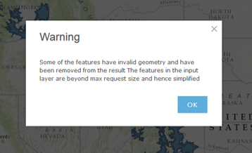

When trying to use the Enrich Layer tool in ArcGIS Online on a feature service of drive-time areas, I'm receiving a warning message:
Warning message received whil trying to enrich data to feature service in AGOL.  Three features in areas with data available do not rececive data.
The drive-time areas are shown in the Esri Demographics Global Coverage map to have data availability as they are in Washington, Arkansas, and North Carolina. To check for issues with geometry, I brought the feature service back into ArcMap, ran the Check Geometry tool and received a report that did not show any problems with the geometry in the feature class. I ran Repair Geometry just to be sure. Then published the feature service, ran the Enrich Layer tool, and received the same Warning message. Three of the four features I'm attempting to enrich with data are not being enriched with data.
Any help as to why I might be receiving this warning message and have features not be enriched with data using the Enrich Layer tool would be much appreciated.

Thanks for confirming. It seems that this particular study area exceeds the max size of the request because the polygon borders are so complex, it's roughly 2MB worth of vertices just published by itself. There are a great deal of small roads in this region which contribute to the complexity of the borders. We are investigating the max request size of this tool to see if adjustments can be made for a use case like this. In the meantime, I was able to use the Generalize tool in the editing toolbox within ArcMap to reduce the amount of vertices, I was then able to publish that as a service and enrich it. Please let me know if I can share that output with you or if we can help in any other way.

Kris, thanks for sharing your layer with me. It looks to be a complex polygon issue and in particular with the study area in North Carolina. Note that this single feature seems to have multiple polygons combined into one and the request appears to be exceeding some limitation. Did you intend for this study area to be a multi-part feature? This should still work regardless so we will investigate it.
I tested this in a staging environment that has been updated for the next ArcGIS Online release and the only record that isn't enriched is this NC drive time.
KrisReinertson1
Dan -  Yes, I did intend for this to be a multipart feature. North Carolina, like the others, was based on multiple drive times areas calculated from many point features with the Drive Time Area tool, dissolved in ArcMap, and published as a feature service in ArcGIS Online.  As you notice, there are many other multi-part features that acquired data with the Enrich Layer tool. So I'm not sure why the North Carolina multi=part feature is unique in producing an error. Thank you for continuing to look into this.
DanielStauning
