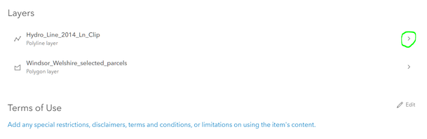

Hello! To enable attachments in AGOL for a feature layer, you do that from the item details page. First click the arrow next to the layer you want to enable attachments for:

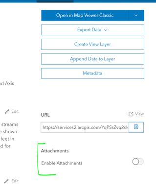

The on the right side of the page, you can toggle attachments.

Katie_Clark
MVP Regular Contributor

LayerItOn
Hi @Katie_Clark and CAustreng_TriCountHD,
I ended up figuring it out thankfully!
First I had to click on the feature layer > item details > then under layers click the layer again (I don't totally understand this, aren't we already looking at the feature layer [not hosted feature layer]? And now I have to look at the layer again under layers?  😶 I suppose a feature layer can have more than one layer, but it's odd when there is only one layer)
Anyways, when I click on the layer > enable attachments on the bottom right
