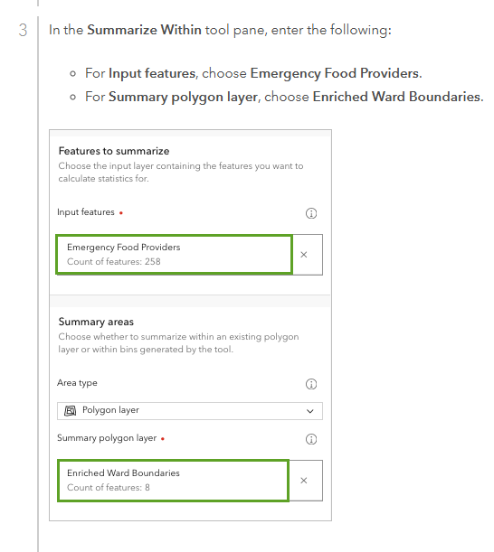

Hey @IntgPlsC thanks for reaching out! I'll be going through the tutorial to see if I am able to reproduce the issue, this might take me a little bit due to the length of the tutorial. Could you confirm if under section "Summarize potential food deserts", question 3, do you have the same 'Count of features' in both the input and summary polygon layer?
Screenshot:

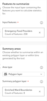

IntgPlsC
Hey Koen! Thanks for responding so quickly.
Yes, the EFP and EWB layers have 258 and 8 features respectively.
Screenshot:
Once again, thank you so much!
