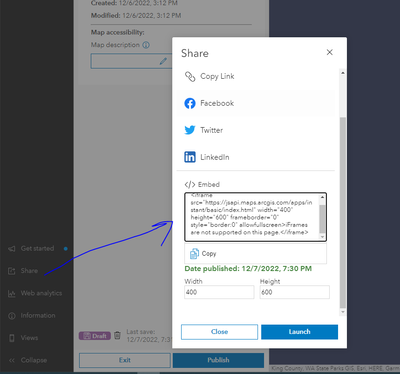

RussRoberts
Esri Notable Contributor
You can create an instant app like the Basic one and once published go to Share option on the toolbar and you will see the embed info
