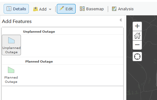

I am trying to create a simple map that have 2 layers (with no data) and I want to create those feature by using the Edit - Create Feature through Arc Online.
When I go on "Edit" through the Web Map or the Web App, I can see my two feature classes
I draw my polygon quite easily but unfortunately when it comes to "double click to complete" the feature goes away and it does not do anything else.
Any suggestion?
