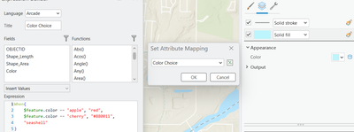

Using a full Arcade expression instead of just a field is easy, here's an example:
As for what you're proposing, I haven't played around with the advanced Dashboard data source options so I couldn't tell you if injecting a control value into the color field(s) is doable, you'll have to experiment with that once you get your layer up and running.
