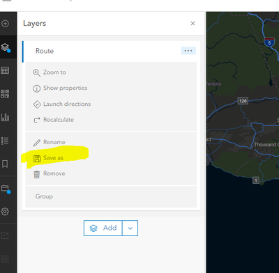

Rhett's answer was helpful in how to continually draw a line - thank you! Related question . . . if a route is drawn using the "Directions" tool, is there any way to change that Route to a "sketch" feature (line) so that a pop-up could be added?
ZaraMatheson
Hello! You can save route layers as Feature Layers from the Layerlist and can customize the popup from there.  You can also use the arrow keys to pan around on the map while sketching. Hope this helps.
lukekm
Thanks for the help - using the arrow keys worked great. The suggestion on doing a Save As on the Route layer seemed like a good one, but when I do that it just saves it as a "Route Layer" to my Content. I don't see an option for saving it as a Feature Layer. Am I missing something?
ZaraMatheson
Hi, sorry, yes I missed  a step. From the item details page for your route layer you can click "publish" and that will save it as a feature layer.
