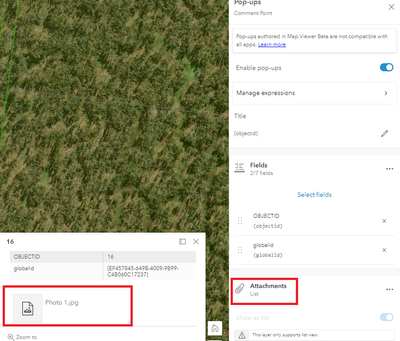

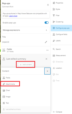

It's possible, the new UI got me as well!
Open the new Web Map Viewer > Layer > Configure Pop-ups.
At the bottom of the Pop-ups configuration pane there is a butt to '+ add content'. This lets you add cool things like more fields, charts, images... and attachments.
Now showing in pop-up: 
