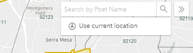

I have a public app that lets citizens look up their evacuation zone (https://santarosa.maps.arcgis.com/apps/instant/lookup/index.html?appid=5ddafd14d6f94c259e75bcd4a5f3d... ).  I would like to disable the "Use current location" option that appears below the address search box because it is not mapping to the correct location.  We want citizens to enter their address instead of using any GPS-based (or otherwise) location tool.  I can't find a place to turn this off in the app configuration settings.  Does anyone know if this can be turned off?  See the sample image.

This is a "brittle" option, but I was able to get this to work by using the ArcGIS Online Assistant and editing the app's JSON.
In the JSON editor, under the Data tab, add the line
"locationEnabled": false,
under searchConfiguration (partial example below)
        "disableScroll": true,
        "search": true,
        "searchConfiguration": {
            "sources": [
                    "displayField": "title_formatted",
The problem with this method is that if you go back into the Instant App's configuration and re-publish it your JSON edits will be overwritten. So you need to go back in and re-add the locationEnabled: false line every time you make any further updates to your app.
