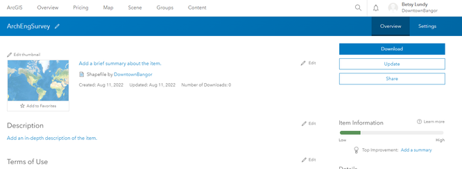

When I add a shapefile this way it does not show as a feature service, only as a shapefile than can be downloaded or updated (it cannot be added to a map, either from the details page or by adding content in the map ).

I am not sure I have an organizational account or that there is any organization that I would be part of.  Note that there is no Organization "tab" along the top in the screenshot above.  I am a single staff at a nonprofit with a recently-purchased Creator license trying to make a simple web map.
