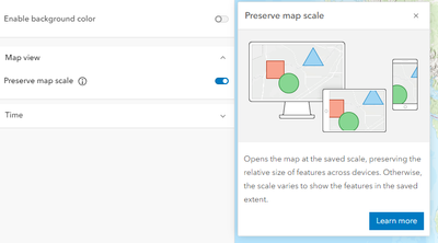

Depending on the view size could impact how that extent is being used. If you want to preserve the scale so all maps open at the same scale focused on the same point I would recommend under Map Settings in Map Viewer enabling Preserve Map Scale.

I've not managed to get this working satisfactorily. I must be misunderstanding what I'm doing. I can't find a combination of options that produce a situation where the user can use any device (without obvious portrait/landscape limitations) and actually arrive at a map zoom/scale level that looks relatively sane and the same.
