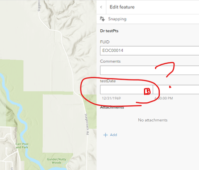

Hi,
I created a web map to edit a few feature classes, and attributes. I have a Date Field, but in Web Map, there's no Date Picker anymore?
If I use the same map in Web Map Classic I do have the date picker and it's working fine in Field Maps as well.... JUST NOT WORKING IN NEW WEB MAP...
Am I missing something?
Thanks!
D

This is in the works for the upcoming release. This will be seen across any apps using the 4.x JSAPI editor widget.
