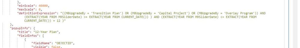

You could probably do this by tweaking the underlying JSON of your webmap using ArcGIS Assistant.
What I'd suggest is add a hosted layer and apply the "in the last 5 years" filter to it. Now, log into ArcGIS Assistant, navigate to the Web Map, and inspect its JSON. The layer information will be in the Data grouping. Find the layer that uses that filter and then you should see an entry for DefintionExpression. That section of JSON will look something like this:
Just copy the text of the definition expression, tweak it to apply to your layer of interest, and then paste it into that layer's definitionExpression property. Since you're directly editing your web map, I would highly suggest making a copy of the map and testing this out in the web map copy first. Make sure it works before you alter your actual web map.

That worked! Amazing workaround thank you so much!
