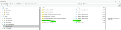

The problem when I use ARCGIS Pro and I search ARCGIS Online, one of our organisation's data layer is visible when it shouldn't be.

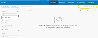

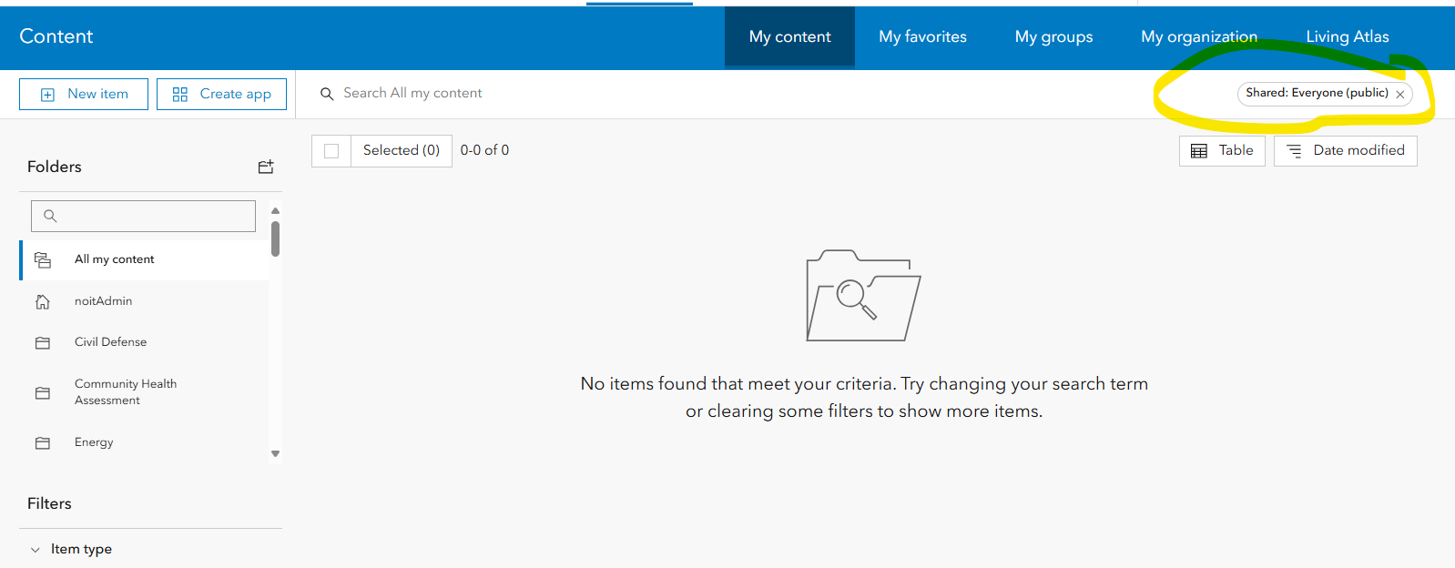

I have checked their settings in my AGOL

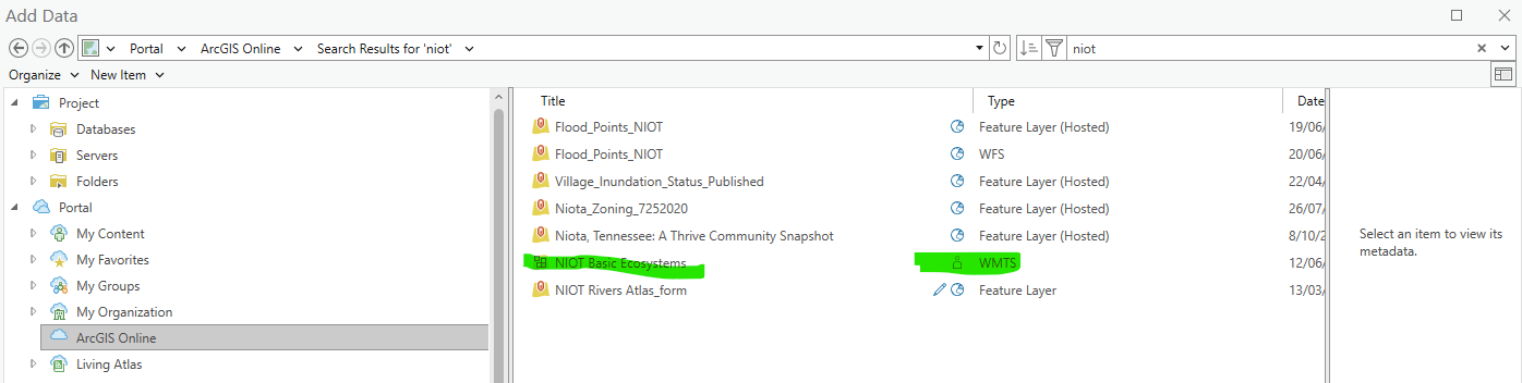

This is from ArcGIS Pro
The weird thing is that if I remove the NIOT prefix from the data layer title in AGOL, the data layer is no longer visible (in Public).

I am quite sure you are the only one who can see this layer in the ArcGIS Online section in ArcGIS Pro. As you are the owner of the layer, you have access although it is not shared. You can see that the symbol for your layer is different from the other layers that are shared publicly (person vs. globe).
If you want to double check the sharing level, you can always log out of ArcGIS Online (or use an InPrivate/Incognito Window) and try to access the layer in ArcGIS Online in a browser.
