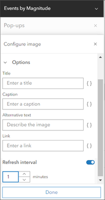

Pop-ups, when left open, do not automatically refresh - save for the Image element. Images have a refresh interval setting:
