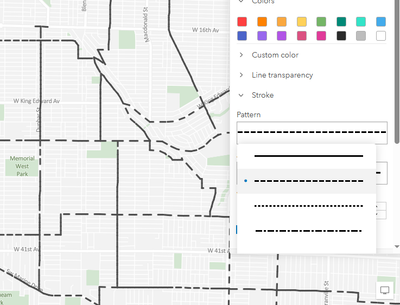

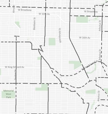

Hello! I am trying to use a dashed line to symbolize bike lanes, with data for the bike lanes coming from a hosted feature layer. When the lines are drawn in Map Viewer, however, the dash patterns are very inconsistent:

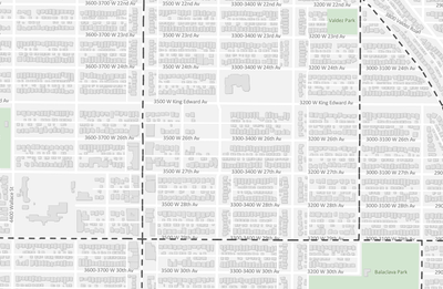

I expected the lines to be joined together, but instead they seem to be drawn per-segment. This can also lead to the dashes disappearing completely at different zoom levels (all lines in this image are symbolized identically):

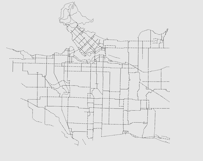

This is a map image layer and the server is exporting the image which is displayed in the map.  Here is the raw export where you can see the similar drawing you mention above.  Also the bikeways look to be multiple tiny features

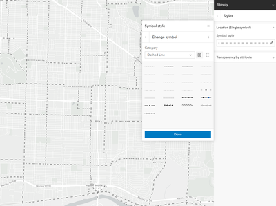

Thanks for the reply! I tried adding the feature layer directly to the map, and unfortunately there's still the same issue:
I suspect that, as you note,  the problem is coming from the fact that most of the features are quite small. Is there any way to connect the features based on their symbology fields? A kind of pseudo-dissolve that could be used to draw the dashes continuously across adjacent features in the same symbology class?
The ideal scenario would be to maintain our small-ish sections of road (which have different attributes for each half-block) as separate features, but have them draw as one continuous stretch of painted lane.
