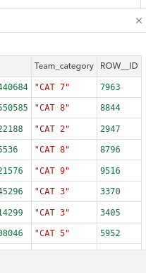

So you're really just looking to add a new field that doesn't exist. The best way to do this, in my experience, is to use Distinct, but to have it return distinct values on the objectID. In this way, the resulting table is the same as your input table, plus any ad-hoc fields you include.
// get your featureset
var fs = FeatureSetByPortalItem(
  Portal('your portal url'),
  // portal item id
  "1234567890abcdef",
  0, // layer id
  ["*"], // fields to include
  false // include or exclude geometry
// convert field list to series of SQL expressions for Distinct function
var fields = Schema(fs)['fields']
var sqlfields = []
for (var f in fields) {
  Push(
    sqlfields,
    {name: fields[f]['name'], expression: fields[f]['name']}
var teamcat_sql = `CASE
WHEN Team_id >= 1000 and Team_id < 2000 THEN 'CAT 1'
WHEN Team_id < 3000 THEN 'CAT 2'
WHEN Team_id < 4000 THEN 'CAT 3'
WHEN Team_id < 5000 THEN 'CAT 4'
WHEN Team_id < 6000 THEN 'CAT 5'
WHEN Team_id < 7000 THEN 'CAT 6'
WHEN Team_id < 8000 THEN 'CAT 7'
WHEN Team_id < 9000 THEN 'CAT 8'
WHEN Team_id < 10000 THEN 'CAT 9'
ELSE 'Other'
END`
return Distinct(
  fs,
  Splice(
    sqlfields,
    {name: 'Team_category', expression: teamcat_sql}
Here's me testing it against a different layer, but showing the same concept. The "Team_category" field is based on the "ROW__ID" value.
