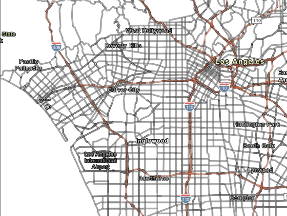

Road shields are by default outlined Red:
I would very much like to have the Interstate road label look like this instead.
Is this possible? Has anyone done this and wouldn't mind sharing their workflow?

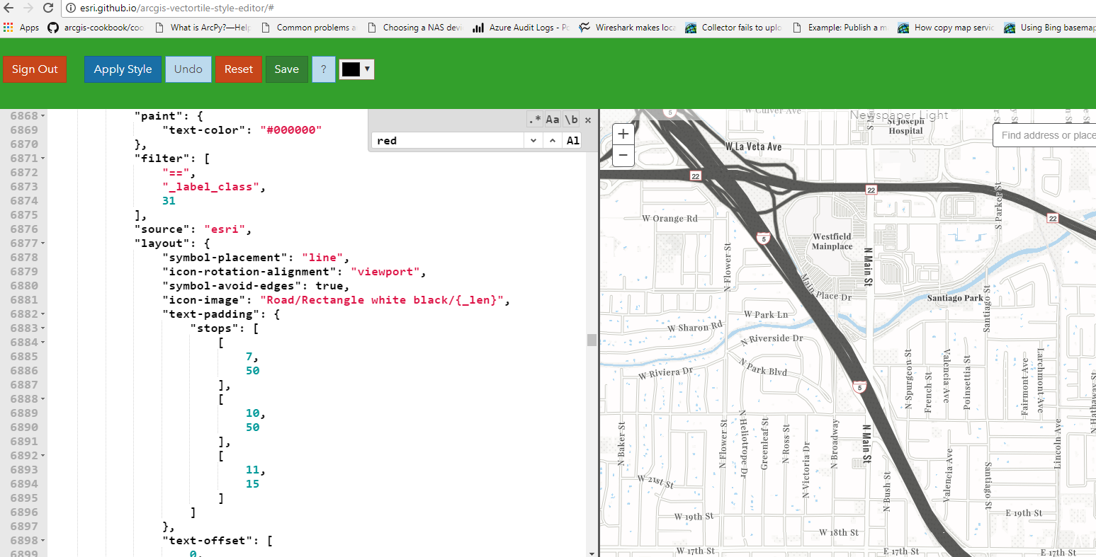

Snippet from downloaded root.json.  I've attached my json style.  I think this is the shield's id?   However, I don't know how to change this out to display like above.  Any advice would be welcome.  Thanks!
SyntaxEditor Code Snippet
{                "minzoom": 7,                "type": "symbol",                "id": "Road/label/Shield blue white (Alt)",                "source-layer": "Road/label",                "paint": {                     "text-color": "#000000"               },                "filter": [                     "==",                     "_label_class",                     8                ],                "source": "esri",                "layout": {                     "symbol-placement": "line",                     "icon-rotation-alignment": "viewport",                     "symbol-avoid-edges": true,                     "icon-image": "Road/Shield blue white (Alt)/{_len}",                     "text-padding": {                          "stops": [                               [                                    7,                                    50                               ],                               [                                    10,                                    50                               ],                               [                                    11,                                    15                               ]                          ]                     },                     "text-offset": [                          0,                          0.1                     ],
