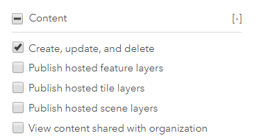

hi all, when attempting to create a new user role, for data collection ONLY, there have been some road blocks. The role should not allow editing of collected data on the platform.
we have attempted to create a custom role with user with "create, update and delete" options

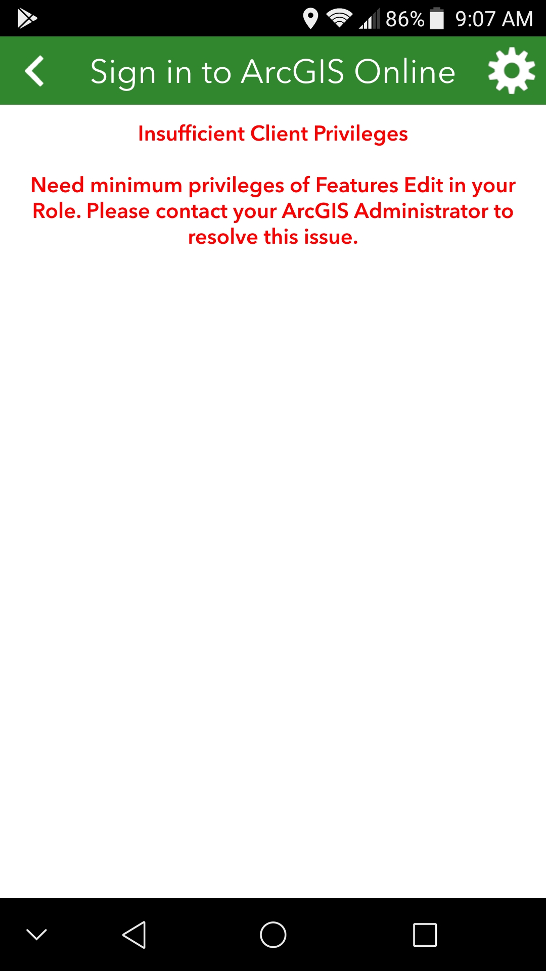

but when the user logs into survey123 they receive the following error message :
Any thoughts on how to do this?

Can you try applying this setting to the role:
KatiePickett1
This did not work for our needs, unfortunately. We need the role to only allow data collection and no editing of collected data.
KellyGerrow
Esri Alum
I would suggest creating a role with the edit privilege described by Victoria Anderson‌.
IF you only want editors to add features only, set this setting on the layer editing settings:
Manage hosted feature layers—ArcGIS Online Help | ArcGIS
