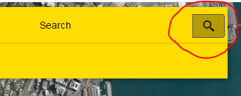

I have been adding some custom CSS to the Basic Template application to try and bring the design more in line with our organisation's branding. I have been mostly successful, but am having trouble changing anything relating to the search button.
Currently it still has a grey colour by default, which changes to white on hover. I want to change those colours. I managed to make changes to the colour and hover colour for the search input bar, but this has stumped me. What class or id should I be looking for?

And if you want to change the background color - behind the search icon you can use this:
.arcgisSearch .searchBtn:hover, .arcgisSearch .searchBtn:focus {
    background-color: #0084A8;
.arcgisSearch .searchBtn {
    background-color:#73DFFF;
I'd love to see a screen capture of the updates you make to the template using the custom css option. We (the template team) are curious about how this option will be used to customize the template.

Hi James,
You can adjust the color by adding the following to the styles.css file:
.arcgisSearch .searchIcon {
    color: blue;
JamesPreston
Deactivated User
Thanks, Jake. This has worked for me, and things are starting to come together nicely.
