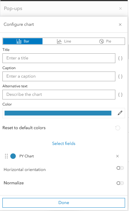

I'm trying to create a chart that displays in a popup, from features in another layer using the current layer as a filter. I have the following code returning the appropriate FeatureSet filtered and grouped as I would like. But the format appears to be incorrect. I can't work out what the correct format is to have the chart actually display the data in the featureset.

You'll have to use an Arcade element instead of a chart. This uses the "media" popupElement in the return. Here's an example with your code that creates a basic bar chart

Thanks mate! That works straight away.
Over the weekend I realised what I was doing was more suitable for the Arcade element as opposed to the Chart element (which would need multiple data expressions to do what I wanted). Thank you for your perfect answer.
