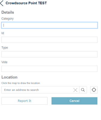

Is there a way in the Crowdsource Reporter application where I can have a drop down of pre-listed categories in the report form portion of the application?
