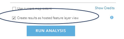

The new analysis on new web map viewer only does manual up to the date of the analysis, so I can showcase all historic points but not use it in real-time.

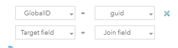

Is there anyway to still use this functionality without Dashboards to display a 2nd layer on the map based on related table field? I was unable to get a duplicate web layer or a view layer to work since it can only point to layer itself to generate a displayed point and not utilize the GUID = GlobalID relationship.

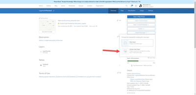

There's now a new way to create a hosted feature layer view from a join, located on the item details page. You can check out the documentation here and this great blog post about the new method.
Please try this out and let us know if there's anything that is not supported for your workflow.
