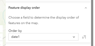

Are you familiar with the feature display order setting in Map Viewer? It's found on the Properties panel near the bottom. It essentially tells the map what feature to display on "top" in the case of overlapping geometries and you can use a field value to drive this (e.g., a date value). This would at least ensure that the topmost feature is the one with the most recent date (and therefore the first pop-up displayed on click).
I've attached a photo of the setting below. If you set this in your map then it should be honored in Instant Apps referencing it downstream.
Taylor
RenBou
I was not aware of that. Thank you! That was very helpful!
