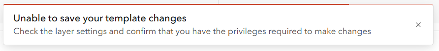

When I go into the Templates option under Configure editing it will not allow me to save the template. The layer in question is being pulled from our server (not hosted online). When I go to save any changes made on the template, I get prompted to login to our portal, which I do, but then I get this error.
I have everything set to allow for editing and I'm an administrator for my organization so I'm not sure what other privileges are needed to get this to save.
If anyone has a clue as to why this isn't working, I'd be eternally grateful. I've been trying everything to get this to work and I'm all out of ideas.

Like @JamesRains, none of the suggestions seem to be working. We're working on an older version of Enterprise (10.9). We will be updating later this year but from what James says, it's not working on the newer version as well. Within Field Maps Designer the templates tab gives me a message that templates are read only.

I apologize for the confusion between Online and Enterprise, but it turns out this is expected behavior when working with non hosted layers in Online.
  • ArcGIS Online supports configuring templates for hosted feature layers only.
  •  For non-hosted layers, the best practice is to use ArcGIS Pro to make any changes.

@MelissaGearman  In case you're still experiencing this problem, I found a workaround for my situation, though I'm working with Portal and not ArcGIS Online. I went back into ArcGIS Pro to the Create Features Pane and edited the template for each symbolized feature. This allowed me to set default values just like I was editing in Pro. I then republished/overwrote the service in my portal and now all my default values show up in the the web/mobile applications. Hope this helps until ESRI can get this fixed in both ArcGIS Online & Portal.
