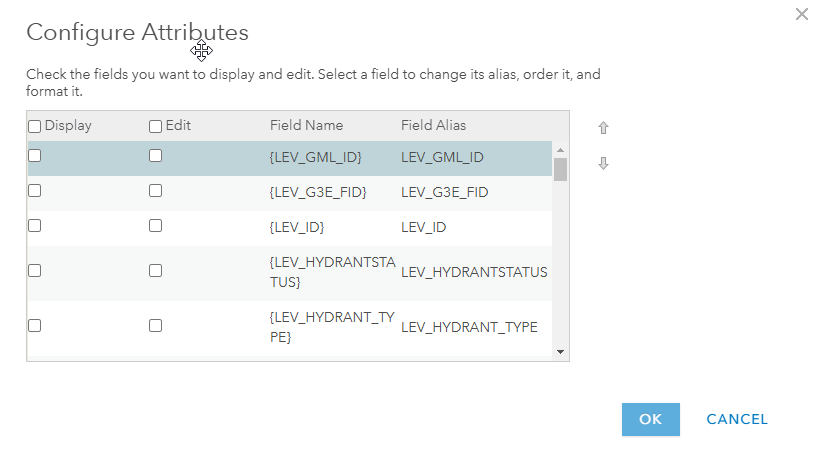

In the Classic Viewer you used to be able to easely configure attributes beneath the 'Configure Pop-Up' tab.
In the current Map Viewer I can't find my way on how to set the 'display' and 'edit' per field. (See picture of Classic View)
I want to set some field to be displayed and only 3 of that selection can be edited.
All this needs to be done so it will be displayed the right way in our Field Maps App and they can only edit the permitted selection of data.
Anyone who can help me?

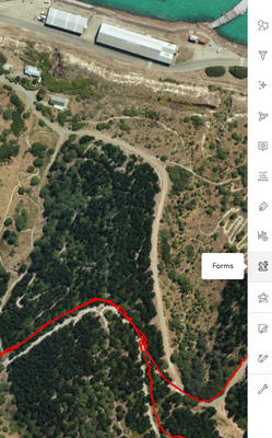

@BrandweerBW - You could achieve this using the "Forms" functionality.
Within your webmap click on the forms.
From there you can configure the form.

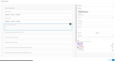

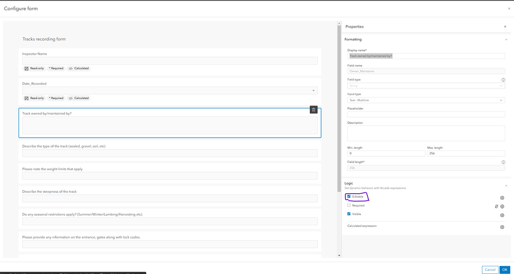

Ensure the "Editable" option is ticked for all questions you want your users to edit.
This settings in this form will be honored in FieldMaps.

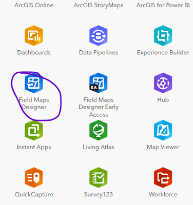

Another way is to use the Field Maps Designer App. Which presents you with more field maps specific options.

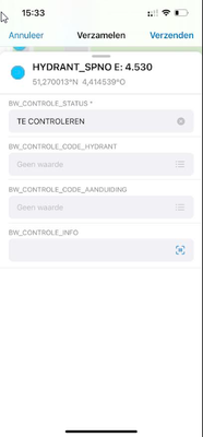

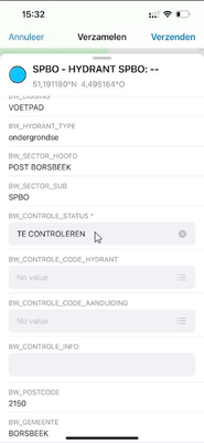

However, when I used to do this in the Classic view it changed the view in Field Maps too.
Here you see that it only shows the topics that can be edited.
Now in the new Map I created, I can only edit the ones I selected but the others are still visible.
I try to find my original settings but they seem to be lost, although they are still being used?!

If you want the users to see certain fields then untick the "visible" setting on those questions.
