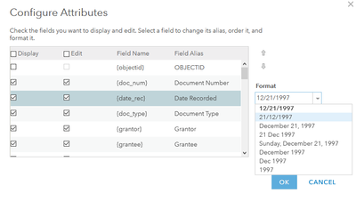

I am needing to change date columns from US format (mm-dd-yyyy) to UK format (dd-mm-yyyy).
Can this be done on ArcGIS online or ArcGIS Pro?
Using the field calculator?
Thank you for any assistance.
jcarlson
MVP Alum

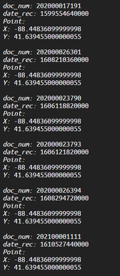

A date field is actually stored as a timestamp, which is just an integer understood to be "seconds since some date".
In order to change how your date field displays in AGOL, go into the Configure Popups → Configure Attributes dialog in a webmap:
According to the Pro docs, the date field display is determined by your machine settings. I do wish that there were more formatting options for datetime fields in Pro.

GWGazza
https://pro.arcgis.com/en/pro-app/latest/help/data/tables/date-fields.htm
Dates are stored yyyy/mm/dd and displayed according to your windows system settings.

DarrenDe_Lange
Thank you Josh, your help is much appreciated.
