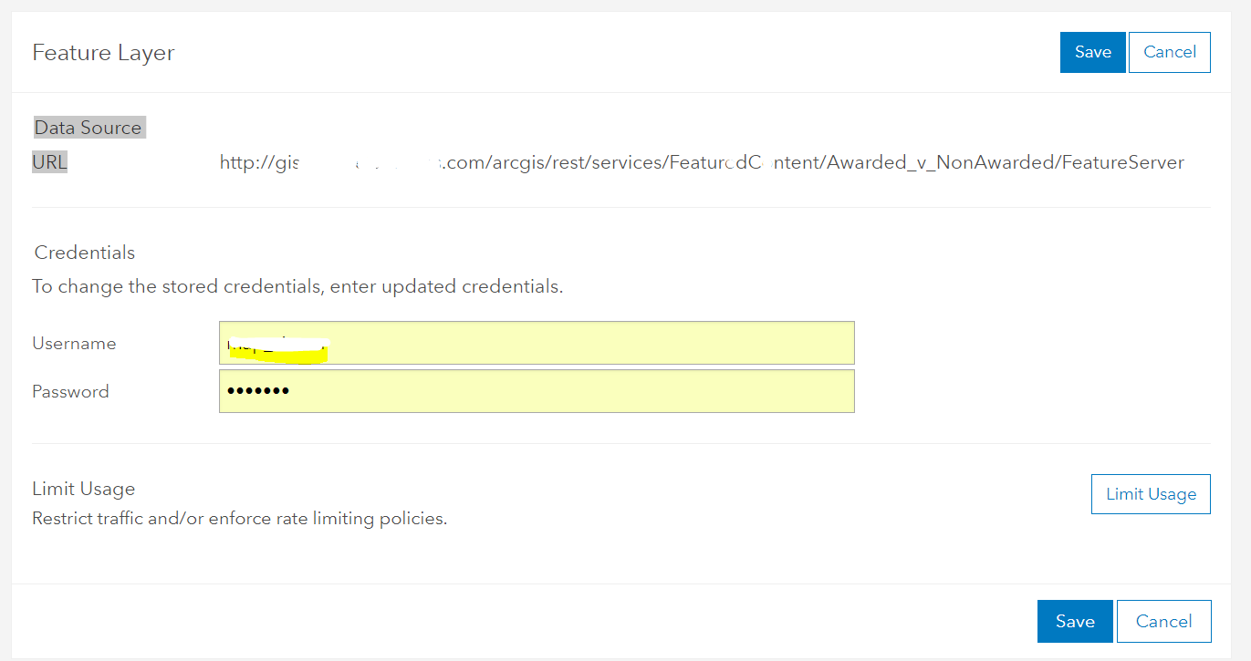

Is there any way to change the Data source URL for a feature service when credentials are stored?
I have multiple feature services added to  ArcGIS online,  the sources of these services are secured  ArcGIS server (10.6.1) services.
The services were added to ArcGIS Online using the option to store credentials. Now I need to change/update the services links and make it point to another machine or link.
Without storing credentials it was easy to change the service link by using the ArcGIS Online Assistant , but with storing the credentials a proxy item is created which securely stores the information!. The service url will look something like the following (in the AGOL and AGOL assistant):
http://utility.arcgis.com/usrsvcs/servers/3ce4ed6b06bfdgfdgthgfgfd/reset/services/A
The below screenshot from the service overview tab in AGOL:
But by looking at the service setting tab the Data Source URL still that same as the ArcGIS server, is there a method to edit this link to something like https://gis.ABC.com/arcigs/services

It does not look like that URL within these types of ArcGIS online Items are is editable in anyway. I attempted making a URL alteration to the items JSON with ArcGIS online assistant, It said the operation was not supported, and  when proceeding it still wouldn't let me, It reverted back to normal. It makes sense to me as the item has a dependent component on the Utilities services, so making alterations might break the items entirely.
Creating a item pointing to a service seems to be easy enough, I think that's the best way to go about adding entirely new services as items in ArcGIS online.
If it's possible to overwrite your services that might be a cleaner way to maintain the URL and any items and maps that currently exist that use them, It would avoid the need to perform this task altogether.
