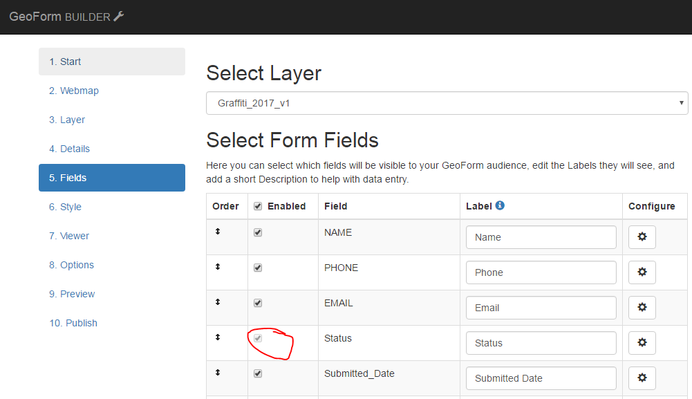

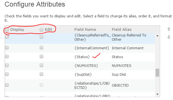

Is it true that I cannot hide required field on GeoForm, even though I have a pre-defined a default value for it?  I don't understand why.  Because it allows me to hide the field in webmap, but still required to show in GeoForm.  It kind of beats the purpose.

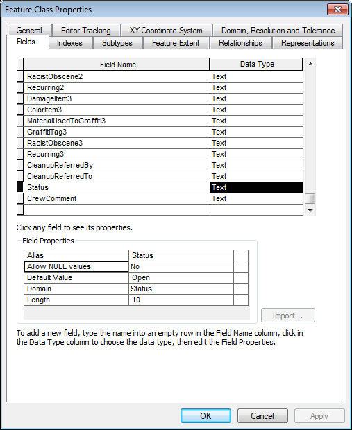

Thank you for your reply. There is a field called "Status" for field workers to update the status of a case ('Open', 'In Process', or 'Completed') from Collector.  The same feature service is being used in GeoForm for the public to report new cases. So, I've set the default value of the "Status" field to 'Open' and does not allow NULL values when I created the geodatabase in ArcCatalog before publishing it into a feature service.
When creating the GeoForm on ArcGIS Online, I was able to hide the "Status" field from its web map, but from the GeoForm's configuration page, in the Fields section, it does not honor its web map's setting and all required fields are not able to disable (uncheck).

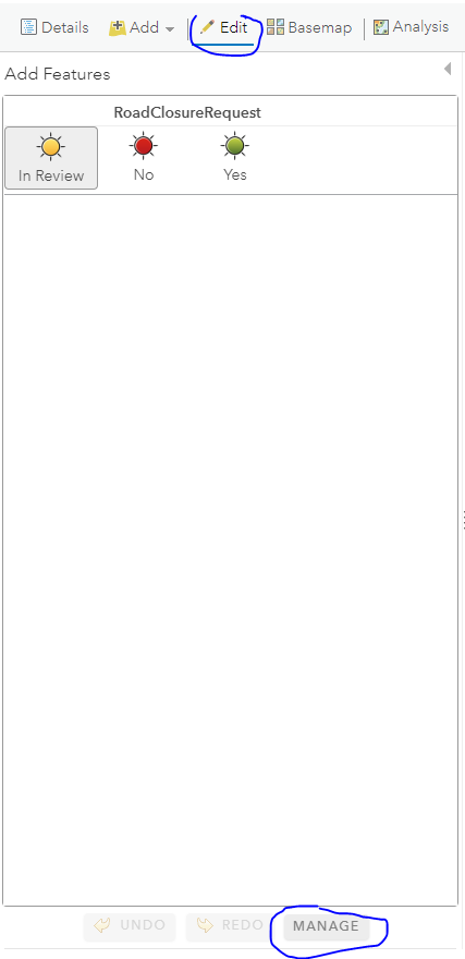

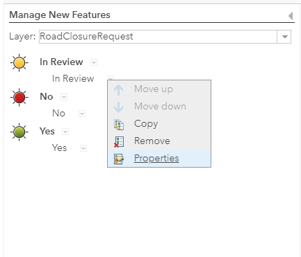

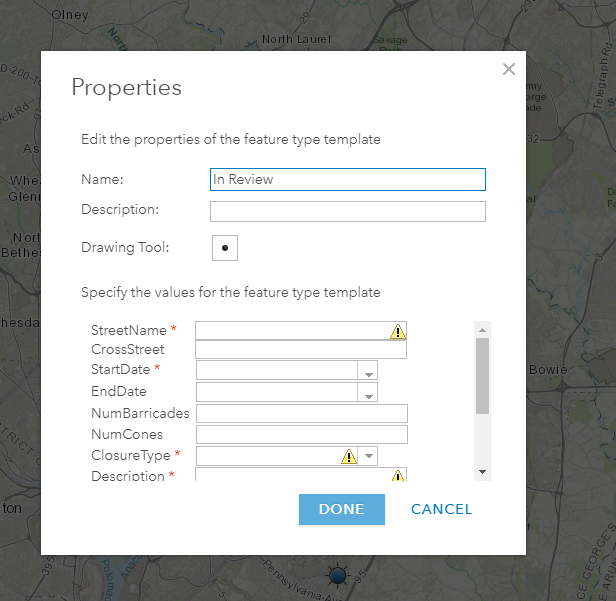

I have discovered that if you set a template for a layer then it will require that field in GeoForm under
Edit and Manage
Properties
This brings up the template info. Anything you set with a default value here will be required in the geoform. If you want to hide that field you have to clear the template value.
