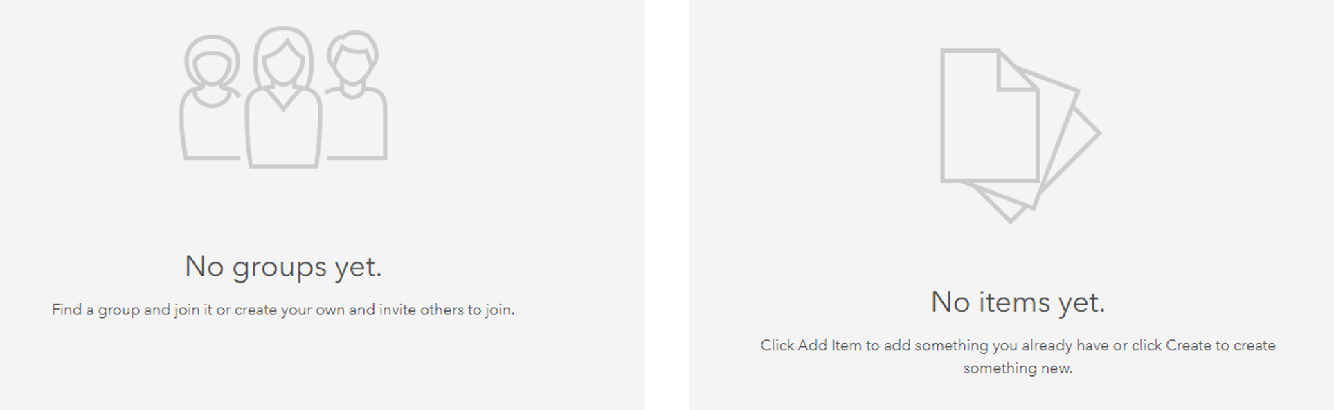

I am trying to delete a user ID from ArcGIS Online, but I keep getting the 'Unable to delete member: <ID Name>. Member must not own items or groups.' error message. I have either deleted or transferred all Content and Groups - nothing shows up when I view Content or Groups for this ID.
This ID is a Creator type and not an Admin. And no assigned licenses.
Does anyone know of a solution to this issue? Or is there something else I need to look at? Is there a force delete option? Haven't had any issues deleting other ID's. I'm guessing something is hung-up somewhere??
This is what you see when logged in to this ID:

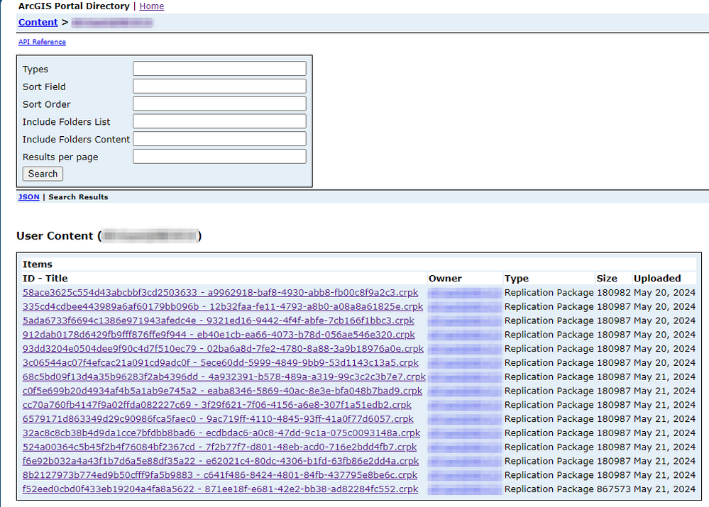

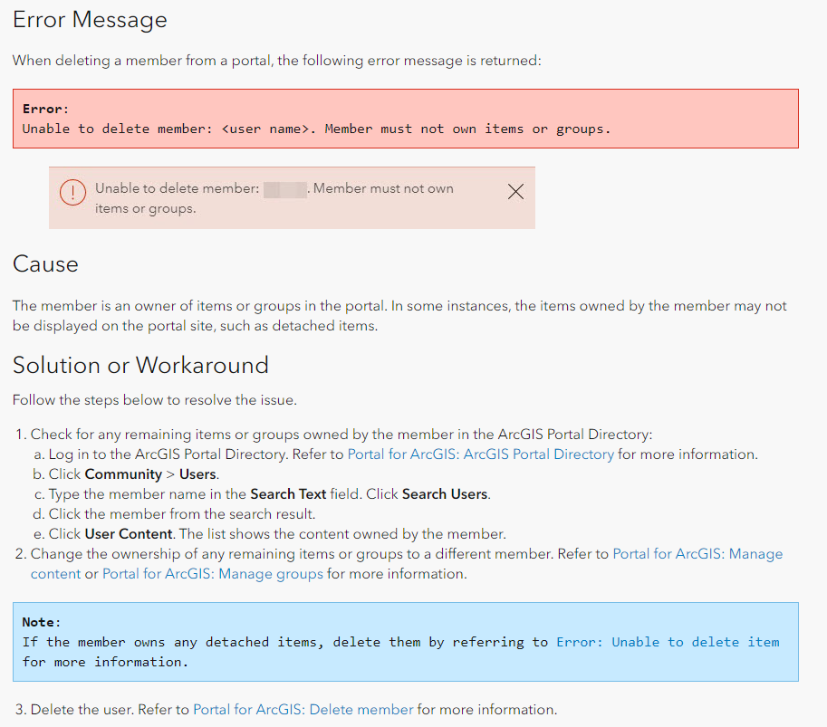

alex_friant
I wanted to use AGO Assist but we could not login as that user as the IWA user account no longer existed. We needed to use the methods outlined here to delete the hidden ("disconnected") contents, which turned out to be a bunch of replication packages from distributed collaborations.
With those deleted, we could then delete the user, finally.error_delete_user.png
