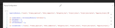

@BillSchlatter ,
I have a suspicion I know what's going on. Try adding the Expects() function to your script, like so:
I opened your map and added it and it seemed to work as expected after I made this change. I just added the fields you had referenced in the includeFields variable since I assumed those were the only ones you wanted returned in the pop-up. If you need additional fields, then just add these into the Expects() function as well.

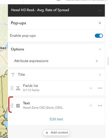

You mention the data is public - are you able to share your web map or at least the data to help with troubleshooting?
And also, just getting the silly but simple question out of the way...do you have a Text section added to your pop-up? Even if you have the attribute expression configured and it's returning data successfully in the Arcade editor, you still need to apply it to the pop-up.

BillSchlatter
To be clear, this isn't an attribute expression - it's an Arcade block in the pop-up, so it shouldn't need a Text block to be called from.  It's returning roughly half a dozen fields in a format that, as far as I can tell, is supposed to use the same formatting as a standard Field List block. At least, that's how it worked until it mysteriously stopped working.

BillSchlatter
Thank you! I wound up having to use '*' instead of an explicit list of fields for some reason, but that finally seems to have things working. It also explains some of the weird behavior I was seeing before - as I tried configuring other pop-up elements for the layer, the Arcade output would sometimes show some, but not all, of the expected output. It must have been loading the needed data for those other elements, making them available to the Arcade expression. Pop-ups seem like a pretty bizarre place to require something like an Expects statement, but I guess that's what it takes.
